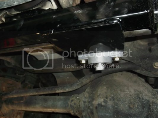

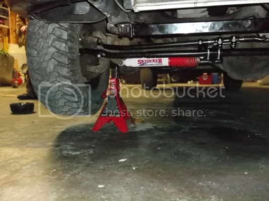

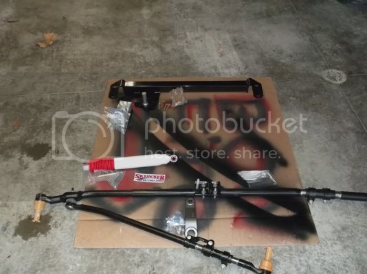

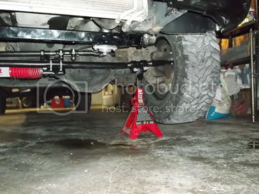

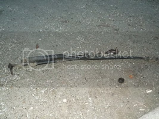

Got my steering box stablizer and 08.5+ steering linkage installed. Def handy to have an extra pair of hands to help you do this!
Parts
Old crap off
Steering box stab on...this thing is heavy duty!
New steering linkage and skyjacker stabalizer

What is the benefit to the 08.5+ steering linkage?
schroederMP
schroederMP
Jul 19, 2011
2,220
112
Indiana
2005
Cummins
Its beefier...and it has a better design.

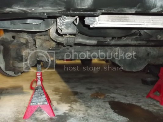

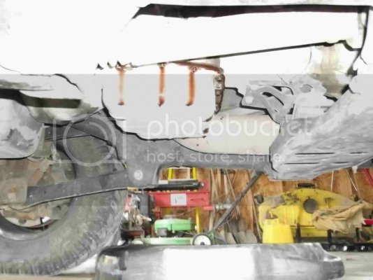

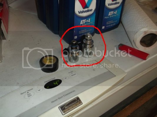

Got my tranny done today... install wasn't bad. LOVE how the transmission shifts now, def glad I did this. (changed the govenor solenoid and the pressure sensor)
Draining fluid
Pan off...what I have circled is the solenoids that I changed. I can already tell a difference in the shifting of my tranny
Here you can see the old one(left) vs the new one (right) Much bigger

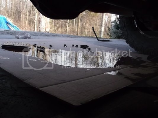

Oh...and I changed the filter. When I was taking it off, a bolt from the valve body fell out. There was 4 more lose... I dunno wtf happen or why they did that. I made sure and snugged them all down

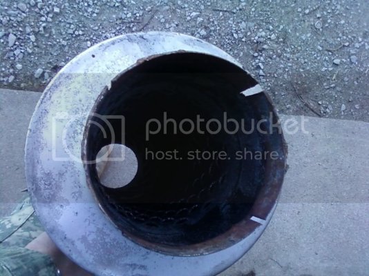

Muffler I picked up cheap... no idea the brand, but gonna find out.
