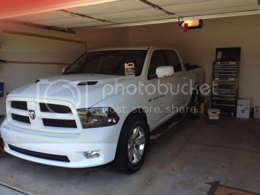

Here you go... Just clayed / polished / sealed last weekend. Just walked out and snapped a pic for you (truck hasn't moved since I detailed it last week).
All nestled into it's spot:
Sweet!! thanks! What is your product routine? As in you say you clayed/polished/sealed....what other products do you use?
