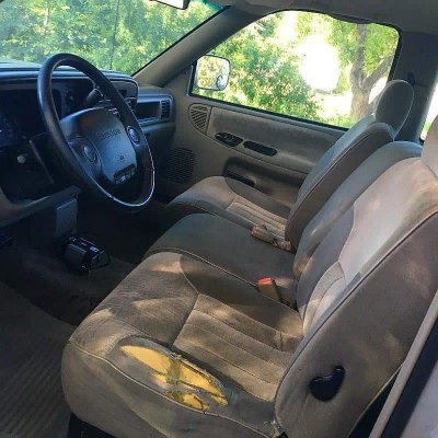

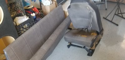

Hey guys. I am wondering if the bench seat in a regular cab will work in my extended cab? I found a mint one at a junk yard but the guy says the shape of the floor may be different and won't work. :(

single cab seats wont fit right without tons of washers, just like extended cab seats wont fit easily in the single cabs.

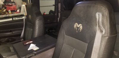

20180913_170849.jpg 20180913_170701.jpg 20180913_192227.jpg 20180913_170650.jpg Found these seats off a 2001 Laramie Dually and it fit my 98

I got it to work! I figured out you could leave the bottom frame alone and just swap the rest of the seat onto the frame. Same bolt pattern and everything!
