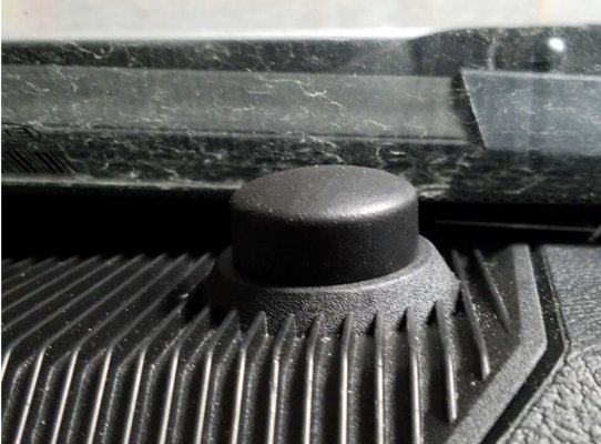

Have always felt like the headlights didn't automatically come on enough in conditions when they should so I made this cover for the sensor. It's an end cap for 1/2" o.d. PVC pipe. I cut about half of the length off with a Dremel tool, sanded & painted it, & put a couple of O-rings inside to help keep it more centered on the sensor. Not exactly rocket science but it looks better than the bottle cap I had previously used.

A better solution is using a tool to activate DRL. This likely makes your dash lights dim, and all lights on on the vehicle at all times. Although not horrible it will shorten bulb life drastically.

Yes, they do stay on but I feel that is safer than the headlights not being on in certain conditions. Saves having to turn them off & on with the switch. I don't drive a lot so don't think the bulb life will be an issue. I can always just take it off if I change my mind. Might considering having the dealer turn on the DRL at some point.

I went ahead and screenshotted it for everyone so you wouldn’t have to go to the website to see it but, I always thought that was the GPS sensor and wondered where the auto-headlight sensor was. I figured it was in the camera on the back of the rearview that operated the auto-highbeams.
But see, the only bad thing about that is, all your lights are gonna be on, and all your dash lights will be dim.
My truck has the premium projectors so I just had another local dealer enable the amber LED turn signal strip DRL’s. Didn’t even charge me to do it and, it saves me 10 bucks a month on my insurance.

If your vehicle is equipped with rain sensing wipers then the auto-headlights is also integrated with the rain sensor behind the rear view mirror. I know this because my 15 ram had the windshield replaced with one that wasnt equipped with the rain sensor so it was disconnected and my auto-headlights would never turn off until i put it back in.
Well I dunno, because in my 18, I have the little black, flat square box that’s stuck to my windshield(that I thought was for the wipers), the camera behind the rearview mirror(that I figured was for the highbeams) and the sensor on the dash that the OP covered up in his, that I all the sudden assumed was for the auto headlights.
I also have the same in my 18. So if you remove that black round puck from your windshield or even disconnect it for that matter then your auto headlights will come on because it thinks its dark out. The round sensor on the dash that the OP covered is also a light sensor but once rain sensors are put in then it uses both. I found this out the hard way with my old truck. My fix was to acid etch the black glass so it had a window for the black puck thing to get some light and voila it worked properly for the lights but could not sense the rain
