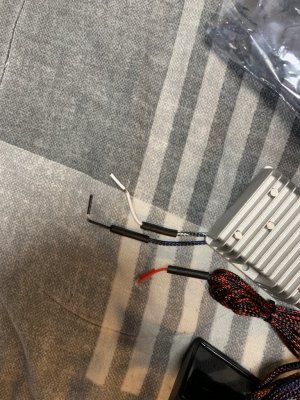

Anyone change out the led boards on ram projectors with sequential switchback flow series from lightingtrendz? Trying to figure out where these white, red and black wires go toupload_2020-9-5_5-46-25.jpeg

Anyone change out the led boards on ram projectors with sequential switchback flow series from lightingtrendz? Trying to figure out where these white, red and black wires go toView attachment 220743
White and black should match up with ur. Parking lights white and black while the red should go to ur turn signal .
