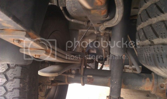

maybe the rear suspension is getting worn out? are your leaf springs in a perfect bow shape? or is it more like this? IMAG0992.jpgwhere in the middle right where the the leafs connect to the axle i sorta levels out?

Actually I THINK the springs arch up over the axle.
