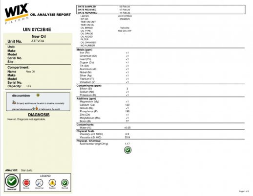

So spec sheets haven't been easy to find on zf fluids or mopar fluids, but I found one on zf 8 lifeguard which is likely the same as mopar fluid, and the stat sheet suggests it is no better then generic trans fluid. Additives aside, someone may decide to do uoa's, and in fact if anyone has any uoa's/voa's on any of these fluids please post them here. So as far as base oil goes, the real pao's of redline d6 and amsoil multi use offer that ZF transmission much better protection in the extremes of cold and hot.
If stats mean anything it suggests the specialized zf fluid is a hoax, not real traditional pao performance in the extremes. It is very weird as Europe and Germany are supposed to have rules against this, but I don't know the minutia or reasoning behind it, I just know stat sheets don't lie, but manufacturers do from time to time. This is an important thing to consider because the ZF operates at such high temps, every owner of a ZF should consider this info when choosing a fluid. We need additive numbers as well for the complete picture.

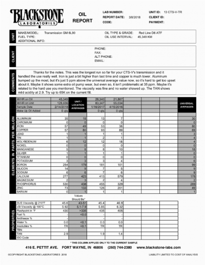

I would bet a wooden nickle that unicorn **** doesn't show up in the uoa's and that unicorn **** isn't in any of these fluids, yes I agree. ZF fluid is nothing special, it fits the profile of every transmission fluid with one notable exception, CA levels seam a little higher then most. There must be plastic pieces in the trans that the CA level protects. I know redline said that is why they don't recommend it for the ZF, but now they do, meaning I bet if you had a recent uoa redline it might have larger CA levels or that maybe their data says not needed. If not you can add a little mgmoa if you ran d6 or amsoil for ins. Those products have half the ca which should be enough, but it is very easy to fix. I don't care what someone decides to run, I just pass out the info and the decision is yours.
If it were me, I'd run redline or amsoil both look stellar. Now there is moly which shouldn't be in trans fluid but in this amount it would lead to trace amount in the sump. i cup versus 14 quarts, another option is find liquid calcium.
