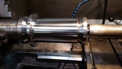

These pieces here are what hard chrome plating looks like after the chrome is applied to the part. Anything you don't want plated you simply tape off or around. The purpose behind the process is you want something plated mainly for the aspect something is going to ride on that surface, so before that surface is plated, it is usually ground to a specific tolerance and surface finish.
The next picture displays the same part, after all the ID turning has been completed. This is what the chrome looks like after being polished. Polishing hard chrome is as simple as taking 240grit down to 400grit paper, placing the part in a lathe, and running the paper across the chromed surface while spinning in the lathe. The mirror finish will pop out in a matter of time, and then you got one hell of a good looking part in front of you.
