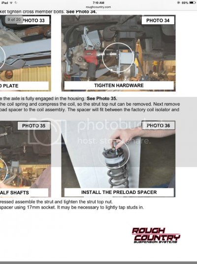

He is right to an extent
The RCX Kit uses a preload spacer for some of its height
The preload spacer should be removed when installing Bilstiens

Idiots. Take it to a real shop. Have the spacer removed and install the Bilsteins. 4Wheels Parts is the Pep Boys of the off road world. Stay away from them.
