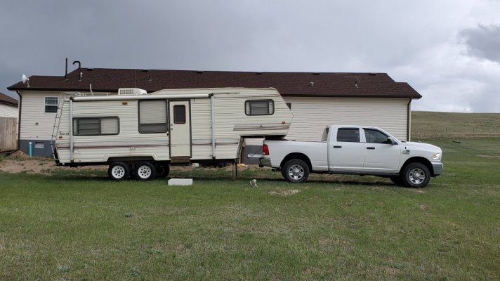

Depending on the camper you might not even need a slider. But of course it might ne good if you go to another trailer.
I can hook up with about 4" of space between the tailgate and the camper when straight on. I do have a slider but never use it.

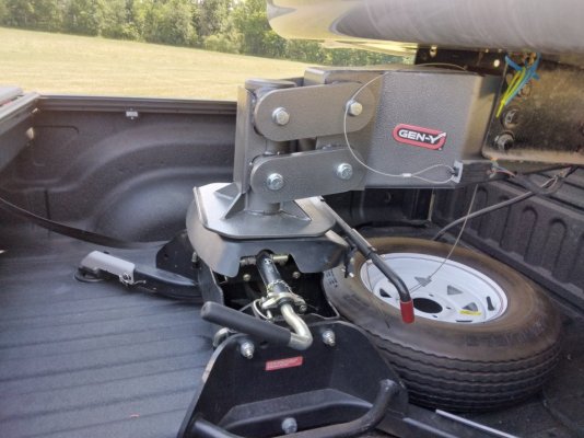

I just downsized my trailer, and now my tow vehicle as well. I came from a dually 3500 , with the 8 foot bed configuration. No issues at all with this set up. But the truck was a monster for anything but towing. So I downsized to a 2500, and its a short bed. Just hooked up my current smaller fiver for the first time yesterday, w/o a slider hitch set up and no problems at all with clearance. I put it thru as tight a turn I could. Many of the new fivers have the 88 degree type caps now a days to clear the cabs in short bed trucks. I really didnt want to spend a bunch more money a yet another fifth wheel hitch set up if I didnt have to. And it looks like I dont need one!
