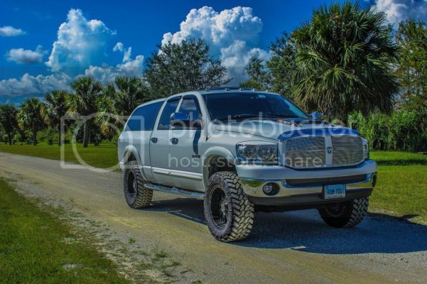

I made my own; stripped the shell, cut out the cross hairs, filled in the holes, ordered and cut the mesh to size, powdercoated the mesh and painted the shell. I then used an emblem from Royalty Core.

What did you use to plug up the holes? And how did you attach that material? That grill looks amazing! I was thinking about doing something like that but didn't know how to do it successfully. I found a grill on Craigslist for $60 it's chrome and has a cracked but thought if there is a way of fixing crack I can sand it down, prime and paint and do a insert similar to yours.

To mount the mesh I picked up 1" galvanized angle iron, the stuff with holes in it and used 3-4" lengths around the perimeter, specifically across the holes where the cross hairs were. Then I filled the holes with long strand kitty hair (fiberglass), sanded down, prepped, and painted. I'm thinking about making another one out of my stock one just to give something different a try.
