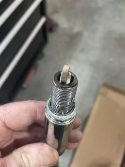

Well WTF is all I can say. 3 days later and the code has not come back. So I’m just at a loss now. I just can’t believe these spark plugs would cause it. All I did was clean it up and switch plugs cylinders 5 with 1. I’m not a spark plug expert but these don’t look bad to me. Guess I shouldn't complain if it was a spark plug issue.

Missed this reply before. Yes they are ngk’s. Came in mopar box and all
From where,there's lot of Chinese knock off plugs floating around these days,and NGK's are one of the ones being knocked off,if you got the plugs off e-pay,and they were cheaper then anywhere else,there's a good chance they're knock offs.The boxes look the same,and the plugs look very similiar to the originals,but they preform like a Chinese knock-off "poorly"
Your plugs are getting due though,as they've started to loose the sharp edges on the electrode and ground strap.The spark jumps from sharp corners better then round corners.I'd think seriously of replacing them if you have them out
The plugs have roughly 18k on them I usually change at 30k but if they need change they need it. Last 2 sets were from amazon. Nothing to indicate it wws knock offs of course and roughly 6 a plug. Mopar site has them for 7. Given its been about 2 years I’d say they were priced right. Maybe next ones come directly from mopar.
I bought gaskets and all needed to pull the intake manifold so may pull that to do a good cleaning of everything I can and replace the plugs in the process. Hard to tell but looks like I may have a leaking valve cover or kind looks like it could be leaking down from the manifold. Guess when I pull it I’ll get better idea.
