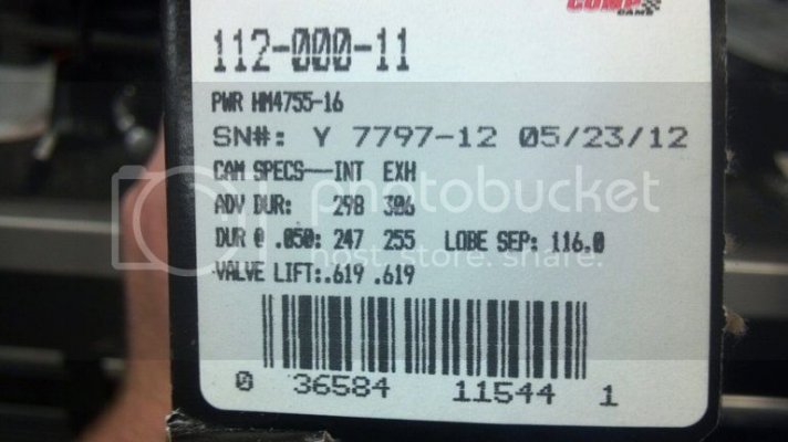

^Ummm VVT motor with eagle heads good times lol. I am not 100% up to speed on yall's options but nothing like a few hours reasearching wont cure lol. Im starting to get more and more into forced induction with the builds the shop does, now thats where its fun. You can make as much power and outrun a stroker on a single turbo fordged 6.1 or 370 ci displacement as you can with a 440 with high CR and a hell of a cam.
Here is a cam on the boosted 426 (really measures 418)
For what is in that motor, a twin turbo fordged 6.1 laid out more power with no where the amount of lag was built.
