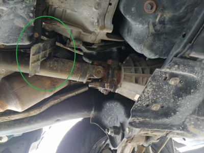

Since you've got a linkage and a 2013 I'm guessing that's the 6 speed transmission... those should have a little plastic shield doodad in front of the linkage, is yours missing or was it caked up with snow and ice in spite of the shield?

We've got a few inches of snow on the ground here but I haven't driven the Ram in a week so it's all dry underneath. I took a photo for you that shows the plastic shield on mine and also I got the skid plates in the photo so you can get an idea of what they cover, in case you end up looking for the factory skidplates.
I've never had any snow problems with the linkage but we don't get super deep snow here and all sorts of factors affect that anyway like how cold it is and what kind of soil mixes with the snow that gets kicked up.. well hopefully the photo helps you identify if you're missing anything at least.
