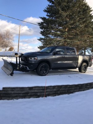

DIRTRIDER
Jul 15, 2013
161
86
2019 REBEL
HEMI 5.7
They make 1500 specific plows that weigh in the 400-500 lb range. My SNOWAY weighs 450 lb. I did a 2” level and installed a Timbren kit to help protect the suspension . I only do my driveway and take the plow off the truck when done.
