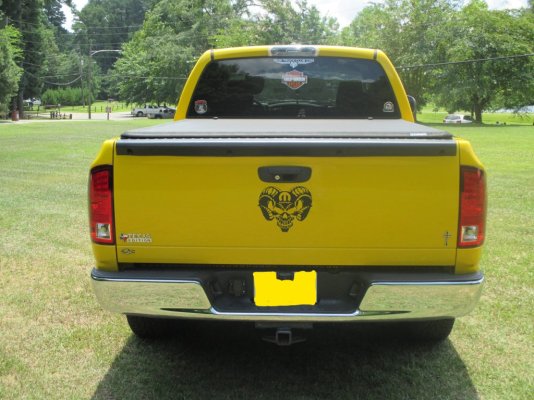

My 2007 Quad Cab 1500 came with the factory tinted slider. I didn't see a real need for a slider on a quad cab truck & felt it was easy to break into the truck thru the window. I had the slider replaced with a dark tinted solid glass window. I am very happy with my choice.IMG_0817_LI.jpg
