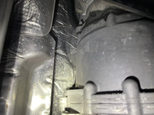

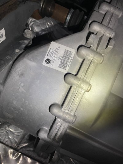

Been dealing with some issues on 2017 ram 1500 V8 4wd. Noticed some leaking and or fluid/grease in a few spots under truck. Also noticed I was able to rotate the driveshaft shown in pics while the truck was on the ground turned off and in park. I didn’t try to rotate it fully but I believe it rotated at least a quarter turn. I have been having some clunks especially when letting off gas and then hitting it again especially after a down shift. Any thoughts? Maybe u joint? Or problem in differential or transfer case?

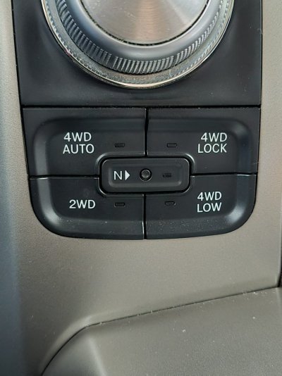

I don't know if this will help, but does your dashboard 4wd switch have the
word "Auto" on it anywhere?
Our 4th Gens mostly come with one of 2 transfer cases that behave differently. Only one has 4-Auto or whatever it says. I would check mine but it's raining and I don't wanna get wet. :Big Laugh:
Curmudgeon
Jul 22, 2017
1,537
4,689
York, Pennsylvania
2014 1500 Laramie 4x4 QC, 3.21 rear, 8-speed
OK, fine. You talked me in to it. My drive selector, does yours look alike
or completely different? I don't know what difference it makes, if any,
but there are folks here who will...

Mine does have the 4wd auto. It was not engaged when I spun that front shaft.
This reference isn't very helpful. How about being more descriptive about the location and volume? A few drops, a pint or quart?
When did you notice this fluid with respect to the development of the cluncking?

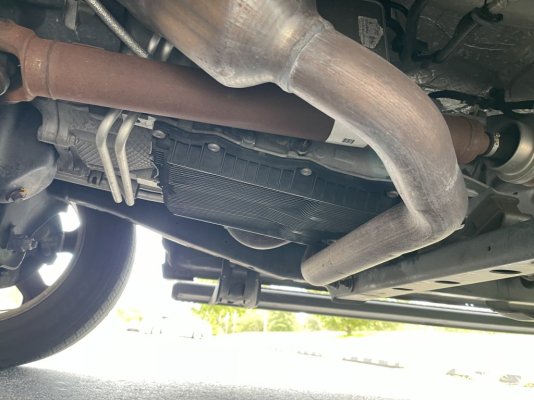

It’s been clunking probably since 30k miles just gotten louder and more frequent. The fluid leak that I noticed is on the trans pan possible the seal or pan itself towards the front of pan. Also a spot above that which I believe is part of the trans. I have a pic but you have to zoom in to see it.

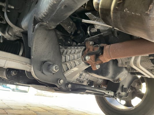

This is the other spot where I’m not sure it’s leaking or just grease from u joint. I believe this is the shaft between transfer case and front diff. I also noticed that I could spin this shaft when the truck is in park and off. The main driveshaft from transfer case to rear differential has no play and does not rotate when in park.

5) Do you have a ZF 8-speed transmission?
6) Do you plan to change the transmission fluid/filter/pan yourself?
The ZF is very sensitive to low fluid levels and has a very specific process for refilling.
Many members have used the PPE replacement oil pan with replaceable filters.
One of the most important and commonly ignored steps is #1, levelling the tranny pan, not the truck.
ZF produced these instructions.
Those aren't leaks,they're just seals sweating,you're worrying over nothing. Unless it's leaving oil tracks on clean concrete,a sweating seal isn't worth worrying about or changing
Didn’t know such a thing existed but yah it’s not leaking on the ground or anywhere that I can tell
Then don't worry about it.When it starts leaving oil on the ground,then it's a leak,but it's very normal to have sweating around seals,and is nothing to worry about.
