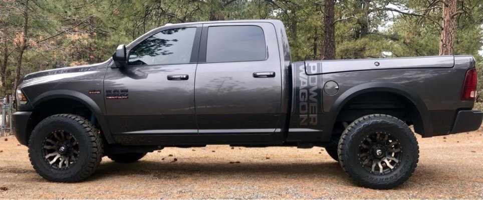

I had my new tires & wheels put on today. I went with 35 Toyo RT & 18 Fuel “Blitz” wheel. Thought I’d share how it turned out. I have one question about the spare tire. Since it’s too big to fit underneath now. Any suggestions on how best to secure it? I haven’t had a chance to try it for myself underneath. Is there anyway to mod it? What do the 35+ runners, do with yours? Thanks in advance [emoji4]3bbaff9c0c576427988247a7c203abe6.jpg

Truck looks great!

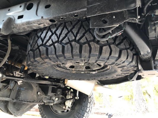

I have seen 35” toyo at’s fit in the stock location, but it had to be aired down a bit. Not such a big deal if you have onboard air. I would give that a try... although you may scrape up your wheel using the factory hanger setup, not sure.

Thank you! That’s great news & yes it helps a lot. I was too busy contemplating having to wrestle the damn tire in the bed. Every time I loaded hay or ANYTHING. Dreading that so much. I missed the easy obvious solution!! Lol. Next goal: onboard air & snow chains. [emoji106]

Buy a used, worn down 35 12.50R17 for a spare or drive 1,000 of miles on a rotated set of 5 new Ridge Grappler tires. Then try putting them up into the spare location when they've all worn down just a bit. Your Ridge Grappler tires are 34.8". Once you've worn off around 5/32" to 6/32" of tread depth they should all fit tight into the spare location tight. From what read on this forum at around 34.4" to 34.6" tires will fit fully inflated. My 34.1" when new tires fit up there quite easily.
I guess it’s one of the live & learn lessons. I just yesterday went with the Toyo Rt. 5 brand new ones. I haven’t had a chance to try it underneath myself yet. Hopefully the same theory with the Grapplers will apply to the Toyos too. Just have to try it & see. But at least I have hope now... thanks! [emoji4]
