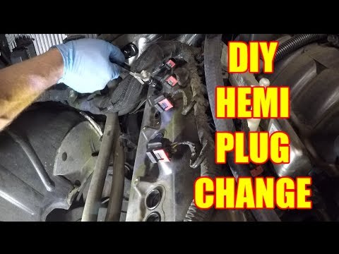

tj4ndirish
Feb 23, 2017
2010
4.7
Late to the party here, but i'm due to change the plugs on my 15 hemi. I found this video and he also references the gearwrench tool mentioned above. Hour to an hour and half and save hundreds.
