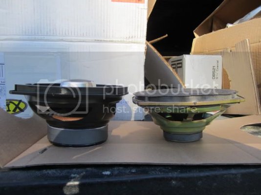

Side Q: Installed the front polk db series 6x9 speakers in the front door yesterday and the tweeters in the center push a little against the OEM speaker grill(door panel). Is this something to worry about and/or fix?

damn. but thanks King, yet again my audio guy. So I either need to cut the door panel or the speaker hole to fit....hmmmmm. Im worried about the power window parts messing with the speaker if its sunk too much farther in. Not sure what way to go.
but no suggestions on wire eh?
freakin tweeters sit sooooo far out
new v old

they really do sound soooo much better. Would never of guessed that just the new speakers would have made such a huge difference. wow

I didnt realize your tweeters had grilles over them. in that case its not really a big deal if they touch the door panels. you could possible heat the door panel grilles with a hair dryer or heat gun and massage them out just a hair for clearance. as far as the speaker wire, id probably just buy a 100ft spool of a decent 16ga. you will have to pass the new wires through the molex plugs in the doors. it isnt fun, but its not really too bad either. i have 2 runs of wire into each of my front doors. If i remember correctly there are gaps at each corner of the molex plugs that are JUST big enough to slip 16ga through. might need to lubricate the wires. try Amp Installation Kits, HDMI Cables for decent wire that wont kill the budget

mine make my OEM grills poke out a little, but the sound is worth it.
