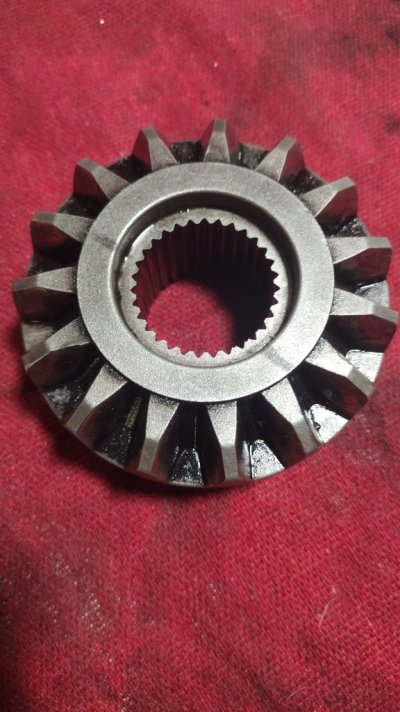

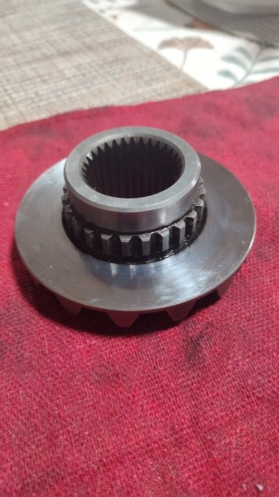

Finally tore up a spider gear guess one too many burn outs. Should have been an easy enough replacement job but I can't find the right spider gears anywhere. Wanted to replace the clutch pack and spider gears but they elude me in my search.
I can find tons or spider gears that say the fit but don't...the ones that came out have 15 teeth on the side gears and 10 teeth on the top/bottom gears. 31 spline.
Any suggestions on where to find them?
Any guidance will be immensely appreciated.

Did you go to the Mopar online parts site and plug in your truck' vin?
Or have they discontinued them?

I did and they said it was this part 68067898AC...But when I got them they were smooth on the back of the side gears no grooves for the Clutch plates to engage and had 16 teeth and the top/bottom had 11 teeth.

Number on the differential case is 68053299AD...Not sure and can't find anything on whether or not I can just remove the clutch plates and put all the spacers they sent in amd.make them fit...but seems like that would defeat the point of the anti-spin

Always an option but if I can find the gears it's a 10 minute job and no special tools needed.

If you've already destroyed one set of spiders,from burnouts,it's time to step up to a better set-up.
