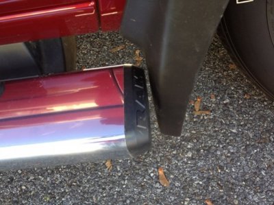

I just bought some splash guards for the front and rear of my 2014 1500.
I have factory side steps and it sure seems like I have the wrong guards, even though I was specific about having side steps when I bought these. Years ago when I bought them for my wife's Aspen, the flap was molded to fit around the running boards. Does anyone know or have specific ones from ram, or do I have to make due with what I have. One thought that I may look into is removing the plastic cap on the front that says RAM, cutting off some of the step, and reinstalling the cap?? I will have to go out and look if that option is possible or even makes sense. I just hope I got the wrong guards and its just another trip to the dealership. ,,Brian

OK here is a website that says they don't work with side steps or fender flares, and I don't see ones that do?? The problem is getting the trailing edge to sit flush against the rocker/lower fender. The outer side of the flap hits the leading edge of the step(the black plastic cap with RAM on it) you have to push hard and bend the flap to come close to seating it, and I don't think the screw will hold it that way.Here is the address that say no side steps,,
Dodge Ram 1500 Mud Flaps and Splash Guards
I will work on a photo when it stops raining, sounds like Monday afternoon.
Any thoughts? Has anyone put RAM mud flaps/splash guards on a 2013 or 2014 with the oval aluminum side steps?? Thanks, Brian

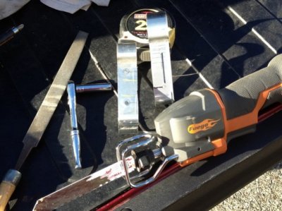

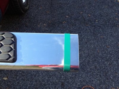

I could not do the swap side to side, because I have full length side steps,,,so today was the day, out came the saw!! I removed the side steps, taped off a 1 inch line and went for it, after some filing the caps went on and new screw holes were drilled and that part was done. Next I held up the splash guards on the truck and marked it with a yellow crayon so I knew where to put the protective tape, last I screwed on the guards and it looks good. Its a slow process but the results are worth it,,,Brian

Dam photos are kicking my but,,I wish I could get then with the text but this will have to do,,,

To the question, was is hard cutting the steps? not really, I just had to fight my normal behavior of, pardon the expression, Ramming through it. Measure, measure, measure, and take your time cutting, check and recheck the line while you are cutting, so your cut stays nice and square. This just gives a better factory finish look when the plastic cap goes back on. Any small variations can be addressed with a file, and don't take the tape off the running board until you are done, they scratch very easy.My measurement showed that a one inch removal would give me what I needed with a little space. Before your make your first cut, try a practice cut on the scrap part to get the feel of how it will cut for you. A thin blade, with a high tooth count is what I used. I fully mounted the splash guards and then did the marking for the protective tape layout. When you buy your flaps, if you go to the dealer, its the stuff they put down below a plastic bedliner.

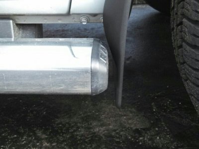

I bought weathertech. No drilling or cutting my wheel to wheel side steps (2013)

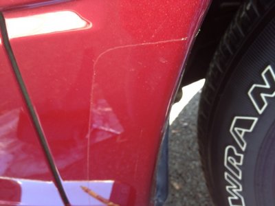

No drilling, have to remove the wheel spats, no clear film included. You can buy clear film if you want. I didn't apply any I don't have any issues with rubbing. The molded mopar flaps there are issues with rubbing.
The only con I have so far is the front flaps don't provide the same wheel coverage as the rear.
