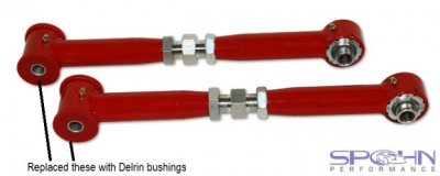

About a month ago, I installed a BT 2/4 drop kit and Spohn adj. panhard, adjustable upper and lower control arms. I wanted to share what the control arms did for my truck.
First, I got some movement in the axle on acceleration and deceleration, and I found out that the pu bushings that came standard on the Spohn control arms where moving around and causing the clunking. So after only 300 miles on them, I replaced the pu bushings with the Delrin bushings from Spohn (additional $6.75 each x8). BTW, the Delrin bushings are hard as rock!

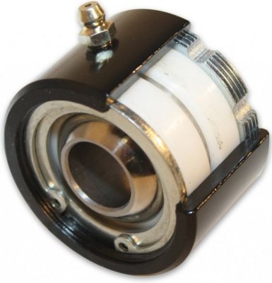

After our talk I got in touch with them over these. I've got the 'older' style of arm that was just a urethane bushing on each end so I've now got the a set of bushings on order plus I'm upgrading one end of the joint to their new del-sphere joint which will reduce the friction on one end of the joint; should be good enough to reduce the noise level as well as add some better movement of the arms if I get it out on the road course.
Cool bro! That's what I have as well, Del-Sphere on axle mount and Delrin on frame mount.
I look forward to hearing your thoughts on these! :)
Edit: BTW, the Del-Sphere joints come with a little tool to tighten them, if they wear or loosen over time.
