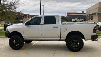

Mind showing me some pics of how yours turned out? I’ll probably do the Bils up front like you and other suggested and then you think I should do a coil spacer to help even it out?

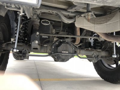

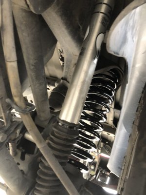

6” Zone with Bilstein 6112s cranked to 2.6, rear coils @ 5”, with Fox 2.0 shocks. I run 37” Nitto Ridge Grapplers. I have a set of TCG 1” rear coil spacers I plan to add when the weather improves.
You can do it in phases. That is what is so cool about lifting.

looks good, you think all I need is a 1” spacer to give it a perfectly level look or maybe 1.5” or 2”

It all depends on your factory rake. Every truck is slightly differernt. Some have 1", others 2" and mine had a 3" factory rake. Before you do anything, measure from the top of your fenders to the ground, right thru the centerline of your wheels. Substract the front distance from the rear and you have your rake. From there you can adjust accordingly. Good luck!

right, those are front. The rears you need sized for the coil. I ended up swapped 3" Fox 2.0s for 5" 2.0's when I further lifted. If you decide to stay with Bilsteins, the 5000 series will work, but again get them sized for the coils.
