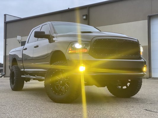

So, a few weeks ago after installing a super 10 cat back system on my 2015 Ram -with MDS- I drove for a few days and using the gear +,- to select 8th gear while driving making the exhaust sound better - I had a lifter failure.
Stopped driving immediately once home (less than 15 km away from where I heard it happen) and found a local shop we've used to do the repairs.
I considered putting a brand new crate motor in, even a 6.2(?) swap, or just to upgrade the lifters and cam to non mds, and get a tune.
This route became the most likely as i'm only in town for school and only had 4 weeks to have the work completed.
Well, last week the parts have begun to arrive. The HV oil pump is on, cam is on the way, and lifters are arriving wed.
Need also a tune to remove the MDS from the computer and needed a new water pump.
We are looking at 10K CDN for the work. When they checked the MDS solenoid they my mechanic said there was a very tiny amount of metal in the screen but likely I'll be fine after several flushes through the galleries.
I just want my baby back here. It's been weeks and I miss her terribly. Any input is welcomed, and is it a good idea to install exhaust headers while this work is being done? Or at least upgrade the exhaust manifold bolts?
Thanks for reading and I'd love to hear your feedback. Cheers
Edit: I forgot to mention the Stage 1 Cam and new lifters are NON MDS. Finally.
