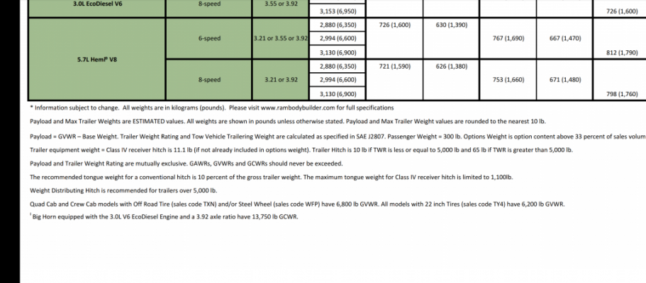

For the record the curb weight of the truck includes all fluids full including gas.
If you look at the fine print in the towing charts it says passenger weight allowance is 300lbs. I'm thinking that belongs in the tow rating number. Screenshot_20210709-092050.png

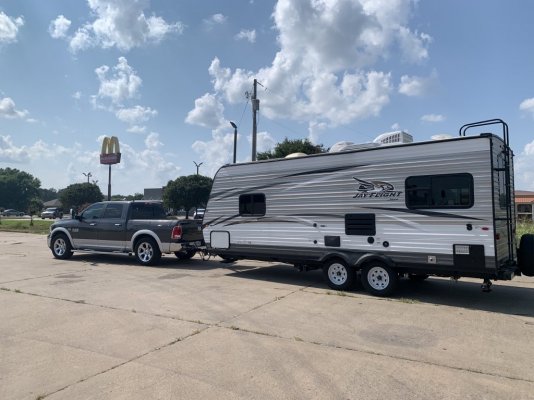

We just completed a 2500 mile trip pulling our Jayco 21QB, which loaded to our camping needs, weighs right at 5600 lbs. We have an E2 600/6000 WDH which came with the used TT. I think I will replace the bars with 800/8000 rated ones before our next outing or maybe go with an Anderson hitch. I had to adjust our current setup twice before I got it into the correct loading specs. No clue what the previous owner used to tow it with. It was very stable feeling at 65 mph which is our max comfort level towing speed. I wish our RAM had the larger gas tank. With all that said, we have already decided to look for a 2500 in a couple of years once all this craziness has hopefully died down.
One other note…. If at all possible, avoid the Indian Nation Turnpike in Ohlahoma unless you want to test the toughness of your tow vehicle and trailer. Absolutely horrible road that they charge you to drive on. We will drive an extra 100 miles next time to avoid it.
