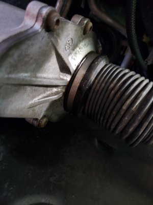

I just went under the truck and had my girlfriend turn the wheel back and forth. Nothing creaked or squeaked, however I did notice on the right side that there was some grease/oil where the CV goes into the differntial and the hose clamp/rubber boot sits. That is the side they did work on though.
