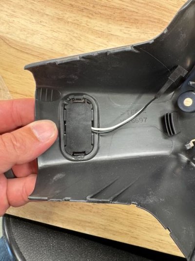

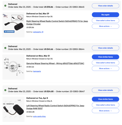

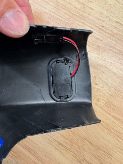

Hey guys, installing steering wheel audio controls on my 2015 express. I ordered what I believe to be the correct parts, but for whatever reason the switches don't match the keying. Well, they're both keyed the same and the wiring harness faces the wrong way if installed on the right and they don't fit on the left.
Are these switched actually different in some way or can I just dremel the notches so they go in right? I just never know with all the canbus and whatnot.
Thanks in advance

So, what's really weird is I've been looking at other ebay listing for these switches and if you zoom in, EVERY ONE has the key notches in the wrong spot. I'm super confused. I might have to just get the OEM switches but those are over $200 together!

Hey guys, no, unfortunately I'm not former military. I wanted to enlist in the navy after high school by my mom wouldn't have it. It's rooted in a nickname for my first Dodge back in high school, a 93 cummins which was green.
Well, you're currently being visited by the big green weenie!
That said, I think your issue is likely entirely due to not being OEM. They may have sent you two of the same part but hard to say. I can say those steering wheel controls are reversible (you can flip them around in thw housing if you want volume and/or seek to switch there up down direction (at least with OEM).
