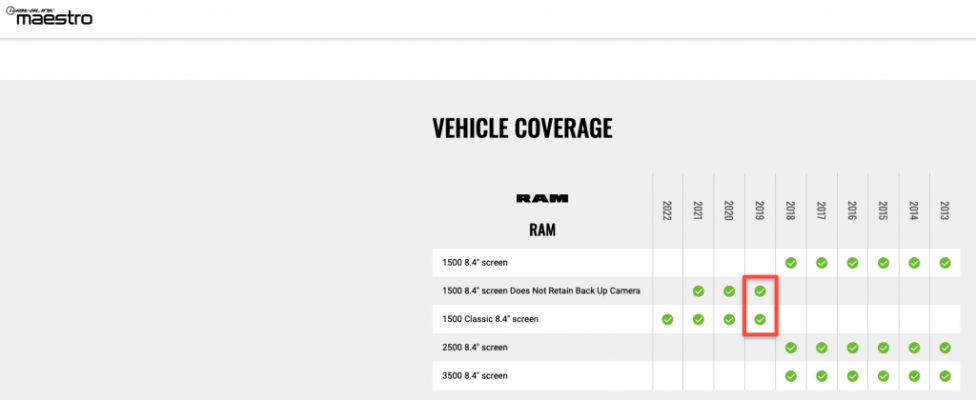

Crutchfield tells me there is no replacement head unit for my 2019 with 8.4 inch and no Alpine. I searched on the datalink maestro site and they did not show a module for the truck either!

@atxmike53 -- it appears to when I plugged in your truck make / model / year :think:
Edit: I highlighted the "Classic" didn't mean to... whoopsie! It appears that there is compatibility with the 2019 1500 (NON classic version) -- but it will NOT retain back-up camera... which is weird. :sad72:
