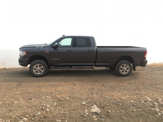

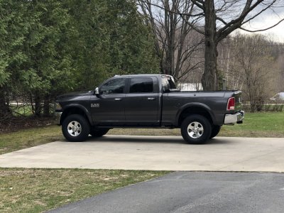

The front will add anywhere from 1.5-2”. I would guess a little less than 2” anyway.
But, just remember, if you add the rear coils too, you will be sitting ass high again. The wagons have quite a bit of rake stock.
I am still running my stock coils front and rear, with 1.5” spacers up front. Still have about 3/4” of rake. Heres a few pics showing the rake with 1.5” spacers....
