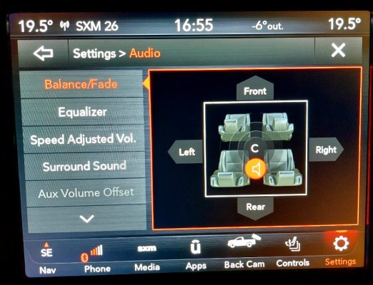

Did you try recentering the balance/fade settings to hear if that changed your perception?

Yah I was not able to find a good balance front to back that was equivalent to the stock sound. I have upgraded the dash and rear door speakers and added some poly fill to the factory sub box. Everything sounds great.
If I had to guess, the factory Alpine amp is probably tuned for that specific speaker combination and that's why your sound stage moved with new speakers.
