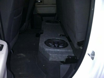

I got cvx's in a box built locally
Sent from my SGH-I747M using Tapatalk
White Beauty
Jun 17, 2013
1,227
314
Moncton, NB
2011 Ram 1500 SLT
