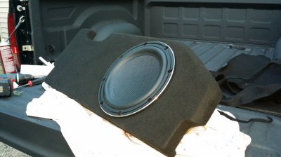

I went with Kenwood KFC-XW1200F. I have one and it sounds great. Definitely does not sound like a shallow sub. And it was $104 on ebay. Crutchfield has them for $200 but that's a no brainer. So 2 10's would pound.

@ Low2HighRise To say "they sound flat," is like saying 4 door sedans are slow. Unless you have heard all of them that is just bad advise.
Everyone's beloved JL W3 and W6 would sound flat not given the proper space.
He only has .61 cu of airspace to work with hence the need for a shallow. The kenwoods require per spec .8 Doing 2 10's with poly fill would give him the lows he's looking for.

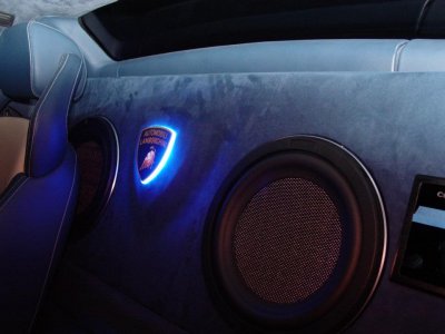

I didn't care for shallows until I heard my buddies Lamborghini Gallardo. They are clean, deep, and look nice to.
