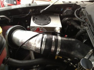

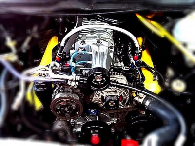

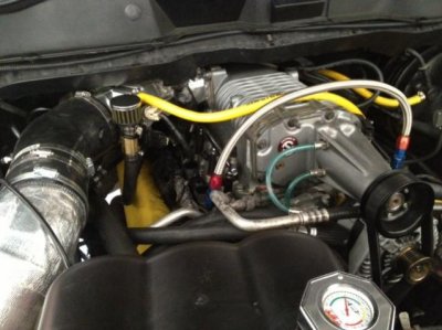

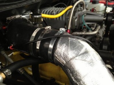

All the work is Solo, with a couple exceptions on having parts made. I didn't have the tools or machines, weilders, large grinders, to be able to make my plenum or custom intercooler adapter plate so those two parts were sent off with instructions of what i needed to be done by nick (airram),. Once done he gave them back i put them together with the rest of this project.
I ran into a lot of issues while doing this but found ways to work around them or mod them. It's running strong and hasn't had any major issues yet. i'll post some more pics for tonight and tomorrow ill break the build down for y'all.
