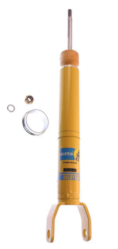

I own a 2009 Laramie quad cab that has a leveling kit in the front. I have been buying up parts to upgrade the front and rear suspensions, ( springs, links, shocks and struts) i made the mistake of buying 5th gen parts and realized that the rear shocks are different. But i was told that the 5th gen struts and springs will give me a bit of extra lift. Now every time I go to make a buy on fb market place for shocks that look the same as my 4th gen shocks , (provision wise). I get stuck when I check the part number online saying that it's not compatible for my year. What's the deal with that ? Is it a brand thing just trying to corner a certain market so that other brands can have they piece of the pie? Bc my year 4th gen shocks have the two bushing fittings on both ends and every after market brand pending g on part number says it's a no fit even though it's the same provision.
kurek
Aug 7, 2019
2,661
3,813
Northwest
See the two horizontal grooves halfway up the strut body? That's the difference between the two OE ride heights on 4wd, 4th gen Ram 1500's.
