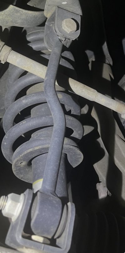

2014 RAM 1500 with 6” Rough Country lift that was installed about 4 years ago. Bad vibration at highway speed for awhile now and front tires cupping. Also that “Wah Wah Wah” repetitive sound from front tires that increases with speed. Noticed these bushings are shot this evening, what are some good replacement options? Would like to keep the cost as reasonable as possible but also don’t want to have to do this repair again in a few more years. Thanks in advance.

Why does it suck so bad? I know for off road it should not even exist for best performance, maybe that’s what you mean, but I drive this truck 99.99% on road. Terrible vibration & tire cupping, so maybe this is the issue… def not doing me any favors. Either way needs to be addressed and am asking for suggestions based on above. Thanks!

I'd try e trailer. They have a bunch and I mean a bunch of end links. Different lengths, different bends, the issue may be the ends are mostly aligned vs offset like your photos.
Or just buy bushings from them. They are great to work with
