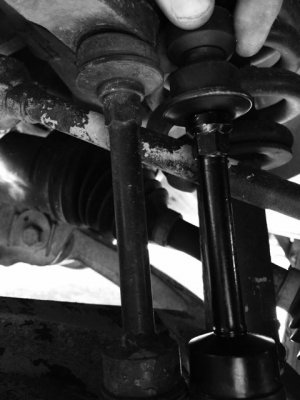

So since I am off a few days I decided to do some routine maintenance on my 2006 Dodge Ram 4x4 sport since its at the 108k mark. Bought some sway bar links from oreilly's and when I went to put them on they are much shorter than what is on my truck. I think the ones on it are original as I bought the truck used so I'm not positive. Are there different lengths? Are OEM ones the correct length? I assume my truck just has a leveling kit. I think there are spacers on top of the coil spring and it's running 295 60r20 nittos. ImageUploadedByTapatalk1425762939.714830.jpghere is a picture of new one beside old one. ImageUploadedByTapatalk1425762965.749593.jpg. Any advise is appreciated!

Looks like you bought the 2WD links instead of the 4wd ones.

Yep returned them and the same guy was there. He clicked 2wd by mistake. Got the new ones in along with sway bar bushings and it already drives better. New ball joints this weekend and maybe shocks and I'll be happy for awhile.
