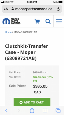

This is up here in Canada for the same part. Well I’m going to take this up with the owner as he also told me he wasn’t going to be charging me that much for labour as they had to take the T case out anyways. BS! Thanks for letting me know the prices that I should be paying.
