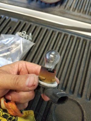

Just got my truck back from the body shop, and shop told me I needed new tail lamp sockets.
Have not had a problem before. Replaced the bulbs easily, but now get a quick ding and tail lamp out message. Either left or right. Sometimes the message was so fast, I couldn't see it. Both work, or appear to when I check.
No local parts stores had stock, so guess I will visit the stealership.
Anyone one else have issues like this?

I see why the dealer said to replace them
The one in the pix really got hot at some time
Yeah, definately. They BOTH were like that, too.
Looks like it will be RockAuto for me. Think they are ~ $12 each for the Mopar ones, and $3 for offbrand. So, not really that bad either way.
