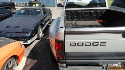

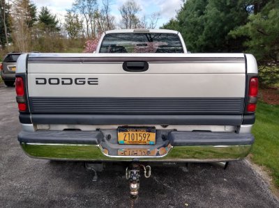

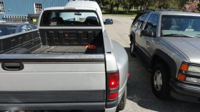

Hello all,
Am new to the site and am in need of assistance. Just bought a 2002 3500 DRW...previous owner had replaced the tailgate with what looks to be a 2001 or older, as it has the ribbed black vinyl moulding along the bottom edge of it. Doesn't fit correctly, as each side of the tailgate has a gap between each end of the corners of dually bed corners. From scouring around the internet, am not finding that there are different sizes (widths) in the gen 2 tailgates.
The width of the present tailgate across the bottom is 62 1/2" and 63 1/2" across at the top. The gap at the bottom from the side of the dually corner is a little more than a 1/4" and the gap at the top is a little more than 1/2".
Want to replace it with correct one, but don't have concrete evidence on what this issue is with the narrower tailgate presently on there.
Any help is greatly appreciated.
