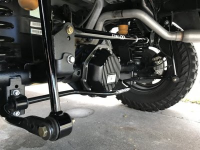

What difference will I notice in my truck if I swap crontrol arms and rear sway bar with a 6” lift?

what made you choose a non-adjustable version of everything?
I have no intentions of lifting or lowering. Just figured it would be easier. No nuts and threads to rust. No worrying about joints shifting. Plus just a cleaner look to me.
On a side note anyone know the torque specs for the rear upper, lowers, and panhard? I have seen some specs on forums but they don't specify rear.
Ya I think it’s a great idea, I just didn’t know they offered that
I used the TQ specs from my lift kit instructions

Thanks for that however from trying to take one of the upper control arms off last night and failing I think that it is much more than 120ft/lb. Gonna try again with a breaker bar. I think Spence will make pretty much whatever you ask for as he did for my air ride uppers and color matching my sway bar.

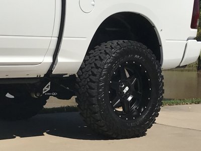

These adj rear control arms are beneficial to 6" lifts so the rear wheel can be put back in its correct position. I noticed on my lifted ram, the rear wheel is pushed more towards the front of the truck. These arms can be extended to move the rear axle more to the bavk of the truck. My only concern with moving the rear axle back, is driveshaft length.

This is what is listed on the torque specs sheet we have aorund for the Upper and Lower control arms
Isn't 200ft/lbs a bit too much ? ********
I put 114ft/lbs on my rear trackbar per a post i found from somebody suggesting that.
In my JK, the trackbars were set at 125ft/lbs, and the bolt was 21mm, which if i remember is the same in the RAM 1500 ?
https://www.ramforum.com/posts/802220/
Joshwaa
Feb 14, 2011
783
197
Lake Worth, FL
2016 CC 4x4 Laramie AirRide
I put upper and lowers to 170ft/lbs nothing has broke yet so guess it is ok?
