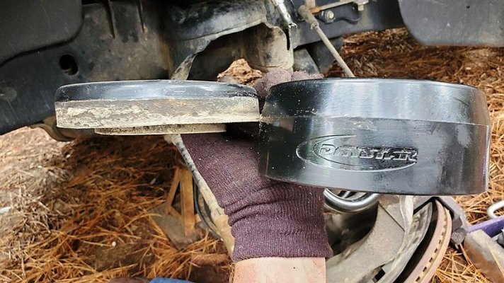

My choice was this Daystar brand 1.5 inch leveling kit. They are cheap and made in the good ol' US of A. And they are supposed to work with totally stock suspension. All that's needed is an alignment after installed.

As in this photo, you can see that these appear to add more than 1.5 inches compared to the stock coil pad. I figure they will compress once in the truck.

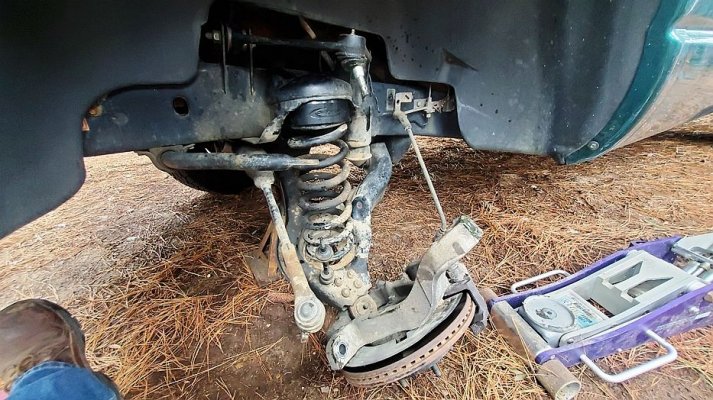

Folks have reported that you need coil spring compressors to do this job. That's not the case. I put the truck up fairly high on jack stands. Then I put a jack beneath the control arm to keep everything level. Once the upper control arm, outter tire rod end and sway bar link were loose, I was able to lower the jack and the coil spring just falls out. On the driver's side, I was able to remove a bolt from a brake hose bracket and there was enough slack that I didn't need to remove the brake hose or brake caliper. On the passenger side, I did need to remove the brake caliper because the hose was not this long. It is sort of tight getting the coil spring back in with the leveling pad, but it's not that hard to do it.

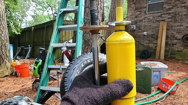

My front shocks were original and had 260,000 miles on them like the truck. So I decided to replace them with some reasonably priced Monroe shocks from Advance Auto. I like the fact that they have about half in inch more expanded length. That should be perfect with this leveling kit. I found a 15% discount code for advance online and used one of my $10 "Speedperks" I've been accumulating. Total cost for the shocks with discounts and sales tax was $52.48.

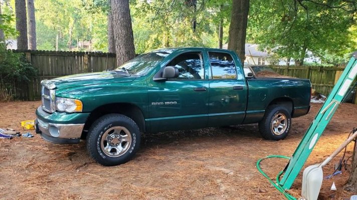

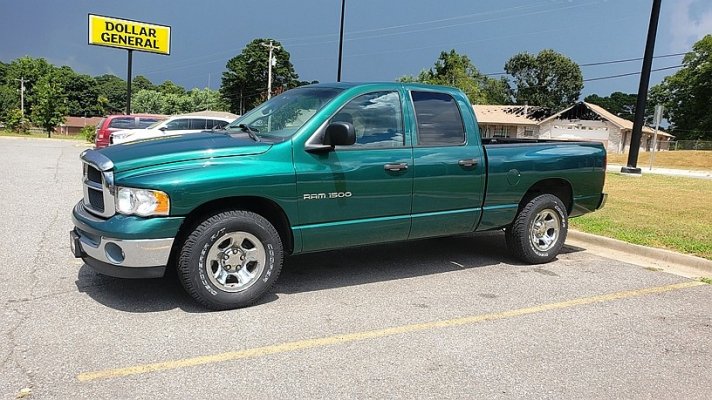

Here is a before photo.

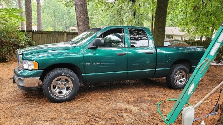

And here is an after photo.

After that initial photo, the front end did settle by that evening after an alignment and after I helped my sister-in-law carry a new front door home from Home Depot. I got a "lifetime alignment" from Firestone. So I figure I will get it aligned again in about a month after everything has fully settled. I think it looks pretty good.

The way the suspension is made, bottoming-out would not be the issue. It would be not having enough shock absorber when fully extended. When I did the lift, I got some new front shocks as well. They are OEM style Monroe Gas-Matic LT shocks. They are slightly longer than the original ones. And so far, I have had no problems at all. The ride is just as good as the original.
