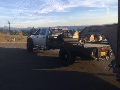

Im attaching photos of the new lights installed (lots of work done to truck as well). I meant to post these earlier to avoid confusion but you guys beat me to the punch.
