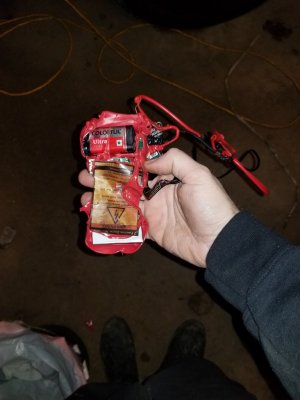

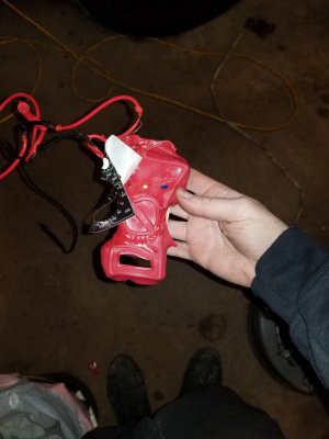

I'm buying a new multimeter tomorrow because I'm an idiot. I set my old one on top of my kerosene heater the other night. It wasn't on nor hot at the time but the next day I went to start it and let it warm the garage for 30 mins before going to work on the water pump. I thankfully came out a few mins later to a smoke filled garage and found It like this (pic posted below). Any tips, tricks or guidance on where to look and what to look for would be greatly appreciated.
