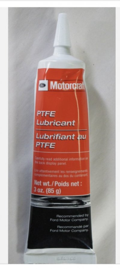

What would be a good anti-seize lubricant to use for the slip yoke?
grizzstang
Apr 26, 2017
1,846
2,888
Calgary, Alberta Canada
^^^I believe this is the stuff Ford recommended for the same issue they had on their F150's.
I used it on my old 03 F150 and it solved the problem. I think I gave the rest of mine to a buddy for his F150.
