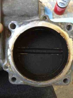

I say all that to say this...a simple cleaning of my engine has turned into a tear down and deep clean ;). So far I've been working on cleaning all hoses, and I have all the plastic (air flow) removed. Of course, this lets me have easy access to the throttle body, so I removed and cleaned it. Here is the before pic...ImageUploadedByTapatalk1347062673.941115.jpg

Very cool. Its always fun to tear into an engine. Its addictive too.
Your TB looked like crap...literally.

Definitely. That's why I'm spending so much time on the air intake areas tonight in the house...and or course I'm replacing the filter...

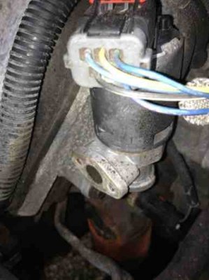

What part is this please. Passenger side front end of valve cover. I need to replace it as it had one broken off bolt in it and I broke off the other ImageUploadedByTapatalk1347127169.881302.jpg
Rambug
Rambug
Feb 26, 2012
138
12
Nm ... EGR valve.
