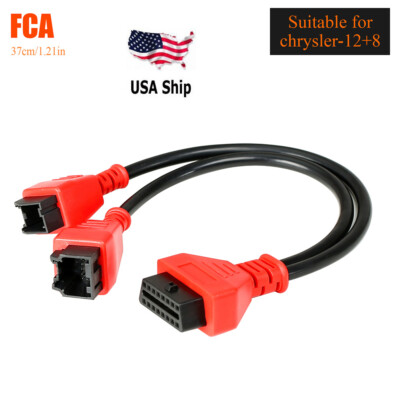

You can buy a LOT of these cables for the price of one of the coala ones
(Pro tip, these work just fine)
