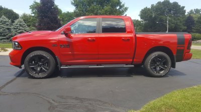

I love the stock 20" wheels on my sport, plus I like the slight rake on it.
