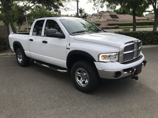

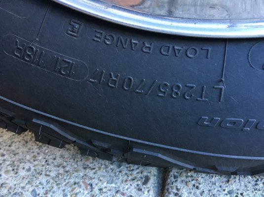

Hello Everyone. I am new to this forum.
I have to get some tires for truck. I am hoping someone can help me figure out what will fit without trimming or rubbing.
I have a 2004 Ram 2500 2wd with a 2 inch leveling kit. Ill be using the stock wheels.
Thanx in advance...

I dont really do any off road. But I want something to fill the wheel wells more. Taller and wider.

My '04 4x4 has 35-12.50R20s with just a leveling kit. It rubbed the fender liner a bit when I got it, but that's because the wheel offset is wrong. You'll probably be alright with 35s as long as you keep them tucked in like they're supposed to be instead of putting them on outriggers.
