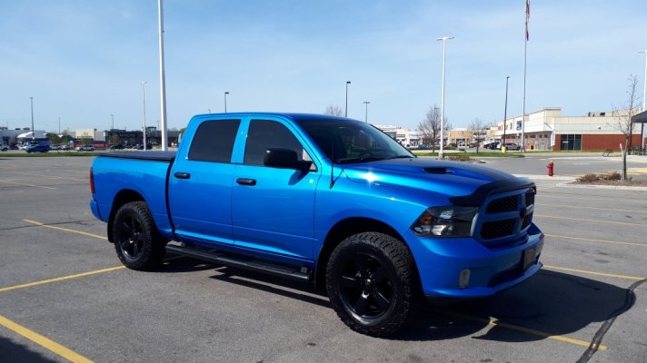

I put LT285/65R20 BFG-K02's on my truck and have zero issues.
And this was before I put in B8 5100 Bilstein's on all four corners; raising the front to the 2.1" setting.
Do the tires stick out at all ? Thanks
Just a little.
They're not tucked in the wheel wells, looking silly...lol.
To me, it's well proportioned. not too wide a tire, but just enough to poke out the wheel wells and give it a nice stance.
I'm not one for super wide tires (on a truck), and I don't prefer to use spacers.
